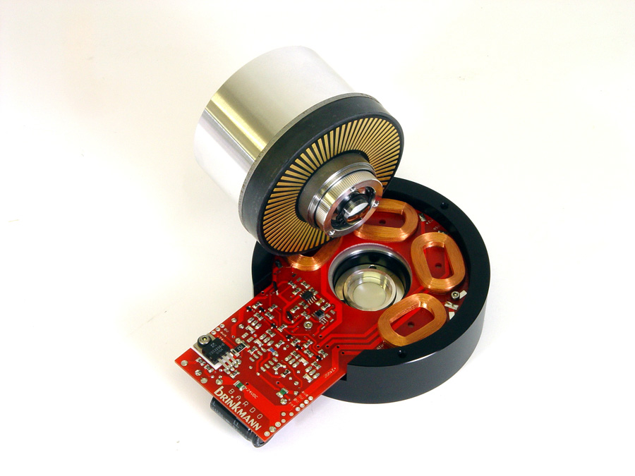

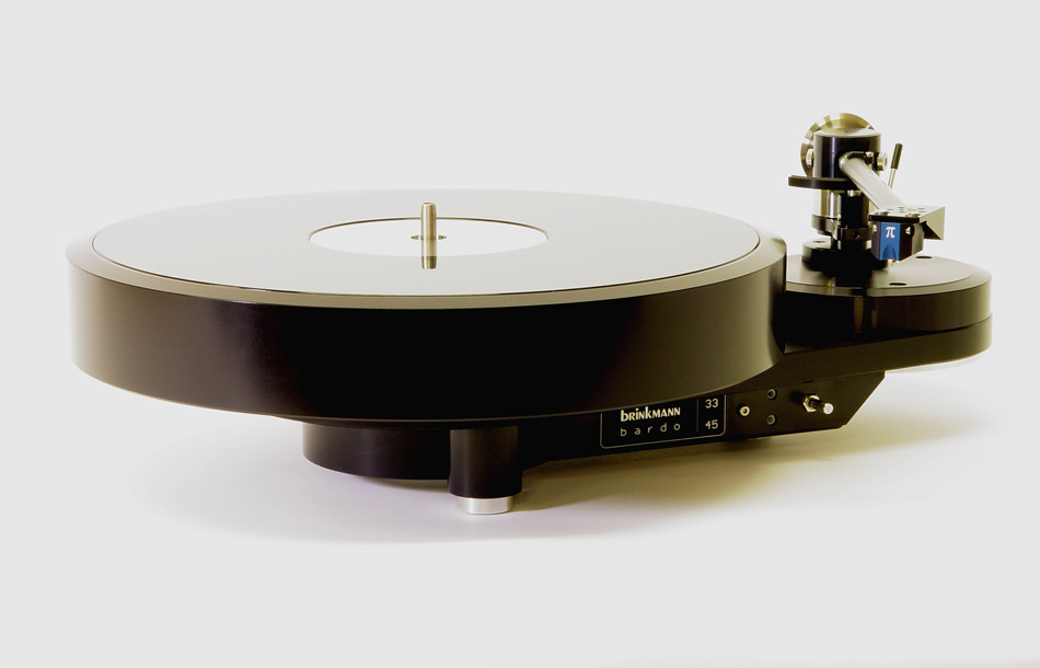

Ενδιαφέρον πικαπ ειναι το Brinkmann Bardo, παροτι εχει Open loop για την διόρθωση εχει βαρυ πλατο (10Kgr) που βοηθάει και εχει σχεδιαστεί για καλό ηχο και οχι για ραδιοσταθμούς:
Many of the known direct drive turntables were constructed for studios and radio stations where it was necessary to have very quick start-up times of less than a second which was achieved with high torque motors that speed up and stop the motor very rapidly. This caused heavy cogging effects accompanied by high wow & flutter numbers. To avoid this, we worked long on a proprietary motor control that transfers just enough energy to the motor for it to remain at constant speed.

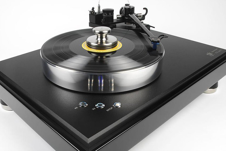

Επισης υπαρχει το VPI Classic Direct που και αυτο προσπαθει να αντιμετωπισει τα γνωστα προβλημα ενω πετυχαίνει εξαιρετικές μετρήσεις.
classic d 1.jpg (80.32 KiB) Viewed 5494 times
Direct drive with no mechanical contact in the horizontal plane. The lowest noise drive and bearing design architecture possible.
A precision inverted bearing and PEEK bearing surface for minimum friction.
Servo controlled with an active feedback loop that measures and controls the speed of the platter directly to yield the most consistent and accurate playback possible.
A high mass billet aluminum platter weighing 18 lbs (8 Kg).
Speed accuracy of .01% or 5 Sigma from 33.3 RPM and from 45.0 RPM.
A proprietary non-cogging drive system that uses the platter as the rotor and a printed circuit board stato

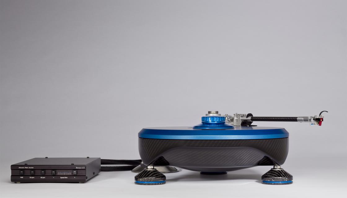

Δεν το εχει ακούσει αλλα υπάρχει και το Grand Prix Audio Monaco 2.0
A technological leap in Speed Accuracy at average 20 parts per billion with peak deviation (speed error) of less than 0.0002% has been achieved with Grand Prix Audio’s new and revolutionary Monaco v2.0 systems. The proprietary slotless motor has infinite pole design and a custom controller with >75,000 line encoder disc, and custom motion control with increased torque which achieves speed in just 2 revolutions. The ultrasonic speed measurement system functions far outside the realm of any playback frequency, and an active feedback loop maintains platter speed by interrogating the platter motion with actual measurements taken nearly 76,000 times per revolution.

Το Brinkmann Bardo που το έχω ακούσει στην Aphrodites Vision (όταν είχα πάει παλαιότερα να πάρω κάτι ανταλλακτικά για το Oracle) έπαιζε εξαιρετικά και μάλιστα είχα μπριζωθεί να το αγοράσω για λίγο καιρό (πριν κατασκευάσω το Lenco).
Αν και λίγο ακριβούτσικο έχει ήχο πολύ καλό και την ευκολία του εύκολου στησίματος και λειτουργίας χωρίς σκοτούρες.
Αν δεν είχα τα Lenco θα ήταν ένα από τα πικάπ που θα είχα σοβαρά υπόψιν.
