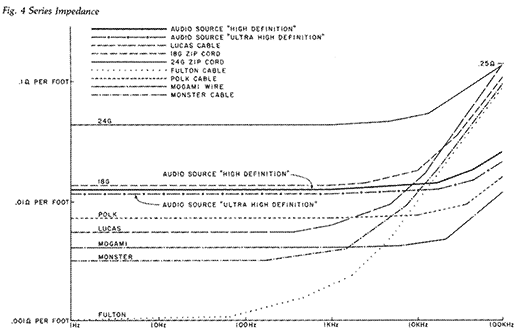

SERIES IMPEDANCE TEST
I tested a 10 foot sample of each cable type using the Fig. 3 setup. I drove the cable by a high source impedance and measured the voltage across it, showing its series impedance. This voltage, referenced to a 0.1 ohm non-inductive resistor and measured from DC to 100kHz, clearly shows the cable impedance's resistive and inductive components (Fig. 4). For the twin lead types, inductive and "skin effect" (an additional high frequency resistance effect) components begin to show up at about 1kHz; they increase the impedance, causing high frequency loss in addition to the cable's resistive losses. Interestingly, all the twin lead types have similar cable inductance values, approximately 2uH per 10 feet, and in the region just above the audio spectrum they are nearly identical. Below 20kHz they fan out to their respective resistance values. The lightest wire, #24, clearly has the most loss, while Fulton cable has the least.
Figure 4 Series Impedance
The series impedance test differentiates the low inductance cables from twin lead as they exhibit an order of magnitude less impedance at 100kHz. Of these, Mogami Wire had the lowest series impedance, by virtue of its lower resistance; but each of these types has to all intents and purposes inductance effects. The series impedance is a more or less linear function of the length of the cable, so a one foot length will have one- tenth the series impedance shown while 100 feet would have 10 times the amount.
