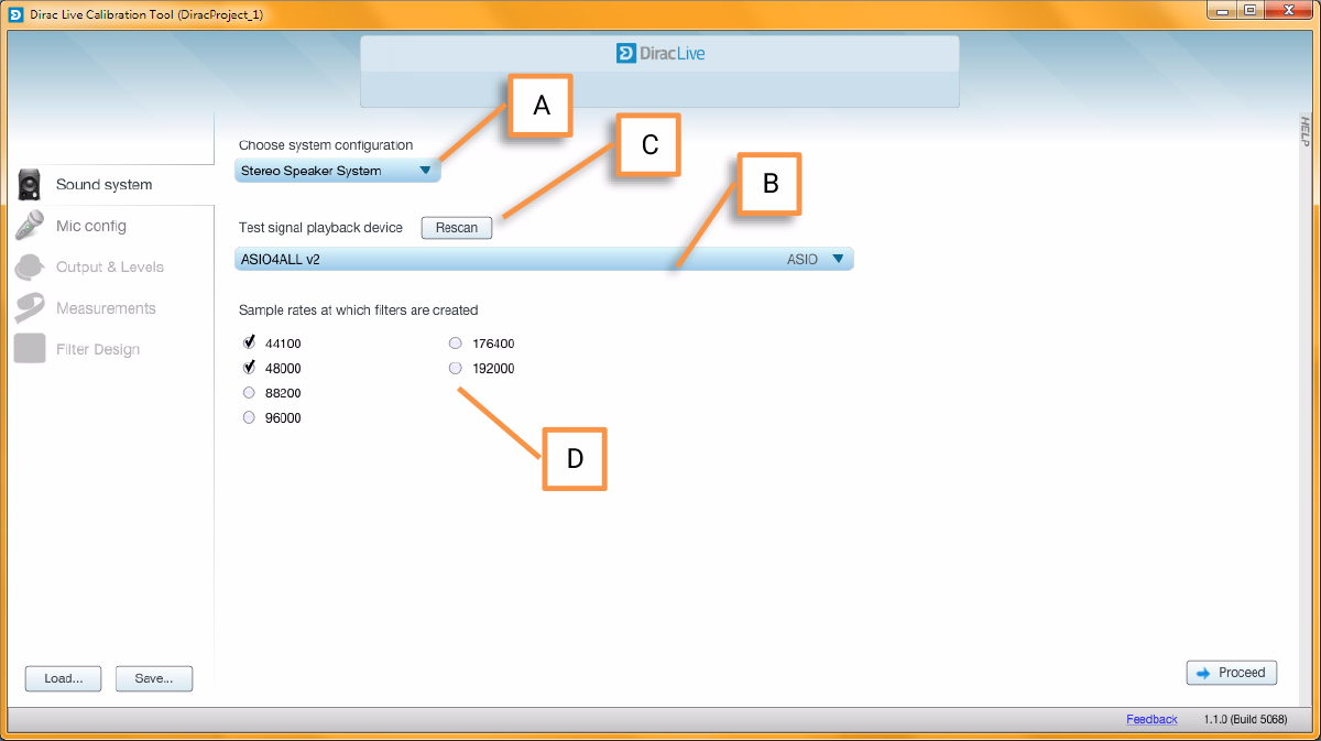

STEP #1: Sound System
A. Choose your system configuration in the “Choose system configuration” drop-down box (A). The system configuration describes how many speaker channels you have in your system.
If none of the pre-defined configurations fit your system, then select “Custom” to freely assign up to 8 channels.
B. Select the sound card or device that you want to use for playback in the “Test signal playback device” drop-down box (B).
Use the same device and channel assignment that will be used for listening.
For Windows users: If available, the preferred choice should be an ASIO device. If ASIO is not available, or if it sounds distorted, then try a non-ASIO device (the same hardware can show up as multiple devices, depending on what audio interfaces its driver supports).
C. If a sound card is grayed out in the drop-down box, it means it is being used by another application. In this case, please close all other audio applications and press the "Rescan" button (C). Clicking the “Rescan” button also searches for sound cards or devices that may have been added after starting the Dirac Live Calibration Tool™.
D. By clicking the sample rate tick boxes (D), you can choose which sample rates the optimized filters will support. Selecting the highest rates will make the filter optimization process take longer time.
Continue to the next tab by clicking the “Proceed” button in the lower right corner or by clicking the tab itself.
