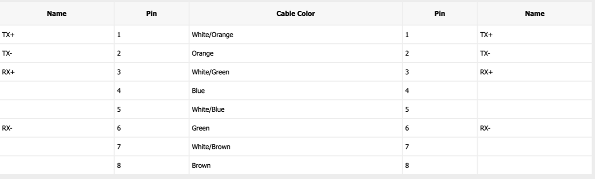

"The cable is tailor made to use 4 wires for 100M instead of 8 wires for 1000M. This is important to know the Port B (isolated port) on Uptone EtherREGEN is running only 100M. So, the extra 4 wires is not used and may create cross talk / any EMI or current which creates interference when the data signal is being transfer from devices."
Επειδή τον καλώδιο AudioQuest Carbon 700 και Telegartner MFP.8.1 CAT8.1 θα το κάνω μόνος, νομίζετε ότι υπάρχει νόημα να συνδέσω μόνο τα 4 καλώδια;
Μετά νομίζω ότι αχρηστεύονται οι κονέκτορες (για τυχόν άλλη χρήση) και δεν είναι και φτηνοί.
Αν υποθέσουμε ότι το κάνω, βρήκα αυτή τη συνδεσμολογία, ξέρει κάποιος αν ισχύει;

Cross talk με ανενεργα καλώδια?
Το βύσμα οντως βγαινει αχρηστο οταν κλιπαρεις τα λεπιδακια επανω στους αγωγους. Θα το συνδέσεις κανονικα. Απο που θα παρεις τα Telegartner?

Ήρθε άμεσα και η απάντηση από την UpTone και τον Alex Crespi, που για μια ακόμα φορά δικαιώνεται ο Παναγιώτης. :-D :-D :-D
"Sorry, but we think the idea of Ethernet cable connecting just 2 pairs is pointless. There is no crosstalk or EMI from the other pairs because with 100Mbps only the two pairs have any signaling on them!
Just build your cables normally and then you do not have to worry.
EtherREGEN is about science and real engineering, not about imaginary things. We like the AfterDark folks (their clocks are good value), but often they (and many other companies) have ideas that are not rooted in anything real.
Of course there is a whole section of “flat earth” measurement people who think that EtherREGEN and UpTone are nonsense also. But my partner John Swenson is a real scientist and was a chip engineer for 31 years so what we do is very real—even if people do not want to understand and accept what we try to explain to them plainly.
